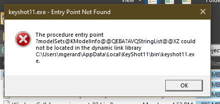

The procedure entry point not found
Hey all, right around the time that I installed the Beta, I started getting this error when trying to open a KS file. I have tried to re-install KS, but not a clean install, just over the top of the current install. I have so many custom materials, models, colors, and shortcuts that it would be a nightmare starting from scratch. I know I can copy all my stuff onto my desktop and put them back, but this doesn’t sound like a KS issue maybe? I can open file from within KS, using the open file dialoge, but just double clicking a file in File explorer ( in this case Directory Opus, which is FANTASTIC BTW) I get this error. its like it can’t find the exe of ks to hand it off to. I’ve always installed KS “just for me” and the exe is actually in the directory its trying to find it in.
Any ideas on how to fix this?

Bit of a rough guess but I think this has to do with Directory Opus and not KeyShot. Someone here had the same using Directory Opus: Procedure Entry Point Errors After Upgrading to 12 - Help & Support - Directory Opus Resource Centre (dopus.com) So maybe a reinstall of Directory Opus does the trick for you as well.

thanks both, Oscar points for searcing that. I did read about it, and did a complete wipe and re-install of a fresh copy of DO, and it did not resolve it. I have not done a clean install of keyshot yet, no time for that yet, in the middle of a lot of projects, so that will have to wait. Fortunatly its not a show stopper, but just hope it doesn’t keep getting worse.
i should have tried to open a file while I had DO uninstalled, but I sped past that and installed it again. Might try it after hours if I get a chance to.
Yeah, there is nothing in our bug database referring to an Entry Point error, so I would assume at this point that Oscar is correct, that’s it’s a conflict with Directory Opus. I would agree probably un-installing DO and seeing if the issue is still there would be the way to prove the issue.
Righto everyone, I’ll uninstall DO and see what happens. Thanks!
OK, did a clean wipe of Directory Opus and I’m still getting the error. Next would be a complete wipe of KS11 and the beta and see if a reinstall works. I’ll keep you posted.
Solved. uninstalled DO, and it still got the error. backed up all my KS11 directories, deleted DO, and uninstalled KS11 and KS2023 (2023 doesn’t do a clean uninstall, BTW, it leaves the folder in the Documents folder. Uninstall should remove everything)
Reinstalled KS11, and now it works. Reinstalled DO, and it works. So, soemthing goofy happened at some point, not sure where. I’ll update if anything else changes.
